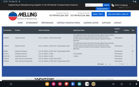

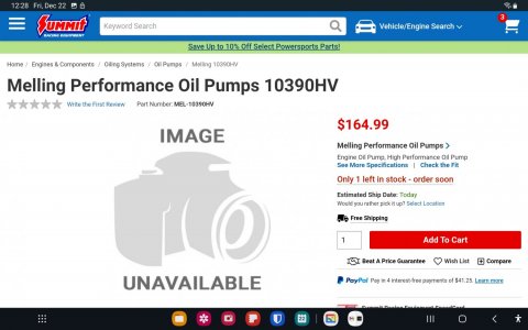

Melling oil pump, there are two, check price the high performance MD stock replacement.
I am sure someone will say it's not worth it get some break-in fluid like melling.
I used 2016, get your VIN lookup again. $164, to me its worth it.
