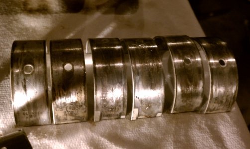

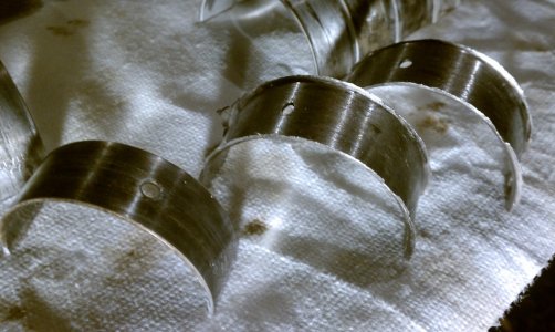

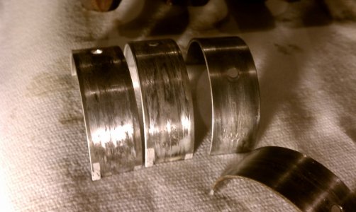

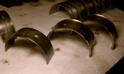

Imag0011
As you can clearly see below VVV, one rod bearing was TOASTED
Imag0012
Imag0013
Imag0014
Imag0015

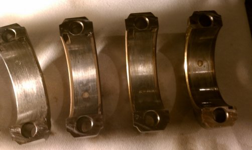

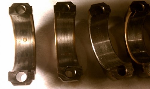

If you look at the pic above and below, 2 caps do not have brown oil rings on them. I do not know if this is a problem, if they have been wore off, or what. Please provide input.

If the crank is scored, scratched, and is not mirrror finished the motor is garbage. and by looking at the bearing at the grooved, pitted, wear on them I can tell you from here that the crank is garbage. Dont buy bearing cause they will spin in 500 miles. Dont waste a pair of new bearings.

First off, your title needs to go, you're no guru with this statement.
On to the point of why your motor is *****...
Look at those bearings! They all look hammered to shit. The one that spun took out the rod cap as well as the rod itself. They're a matched pair, you cannot mix and match caps and rods. If you replace one, you replace both, period.
Then there's the rod caps for the remaining 5 that all have witness marks on them from the bearing moving around (which it should never do). The fact that I can see the witness marks from a low res photo tells me that those caps are also toast.
So, at the very least, you need 6 new rods.
Now, if there was no oil at the bottom end, there was most certainly no oil at the top end, which means your cams and shims took a beating as well. And what is the condition of your wrist pins? How worn are they now?
Face it, this motor is toast. If you insist on buying rod bearings, make sure they're installed in the new engine before you put it in your car.
tl;dr That engine is a write off. Sorry man.
