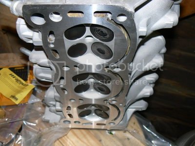

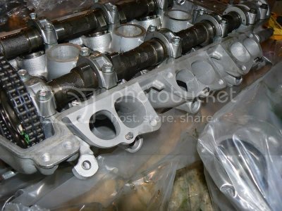

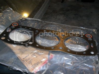

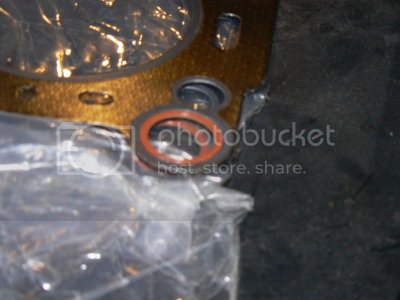

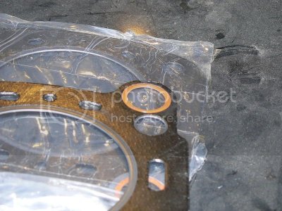

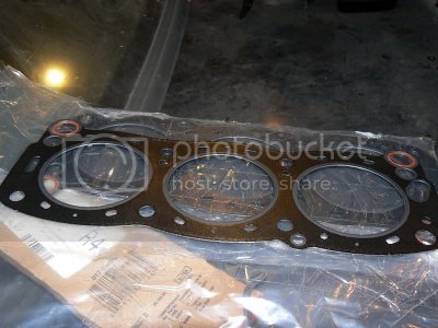

Ok.. now my next question.. which side of these head gaskets is up? I didnt see any writing on it anywhere. And only noticed one small difference.
One side...
P1000483
P1000479
The flip side....
P1000482
P1000481
Just curious which side is the 'top' first set of pics or second? Thanks!

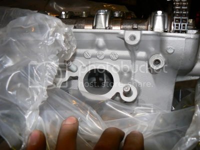

Intake and exhaust side of the front head.. other still in the bag..

The gaskets will only line up with the head and the block - with proper orientation to the holes in one way.
Are those new heads or reworked heads?

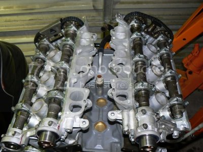

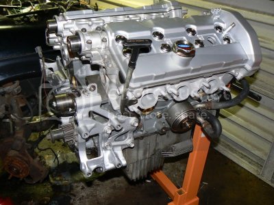

Hey thanks! I did notice that one extra hole after I got it set on the block. I did get it all figured out, just wish that one wasnt so close to the cam. Its almost like you need a LONG tip on the end. Almost thought I was going to have to loosen the cam. Glad I didnt.. enough wiggling and it was good.. here's some more pics.
And they are reworked. Been degreased, new valve seals, guides checked out fine. Had the valves re-seated, installed 2 (newer but used) Chain tensioners, pressure tested, and as they said, good by the factory standards. More pics of the progress..

When I installed my heads on my new 3.2 I did it before I installed the cams - didn't want to mess with them being in the way.

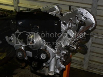

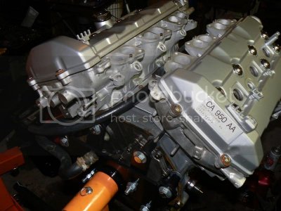

Only thing I cant seem to figure out where they went to, are those stupid timing cover bolts. Guess I'll be out getting some of those here soon. Well she's all timed, and the big part of the front end is on. Exhaust comes tommorow, a few mounts, and I think I'm going to drop her back into place.
