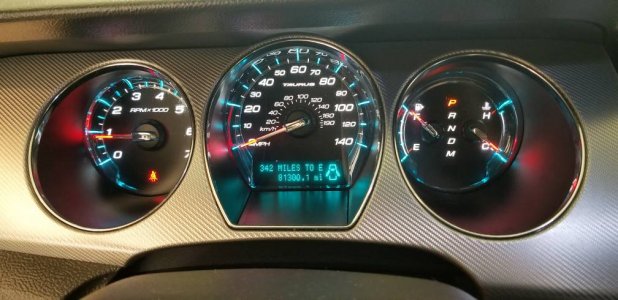

And as of just this afternoon..... I'm now at 81,300 on the clock, w/o a single drivetrain failure of any kind, to date.
Although I am hesitant with new performance goodies going on soon, I am likely heading down that inevitable path of needing to do something to harden/build/fortify aspects of it eventually.
But I've been very fortunate to date. An extreme maintenance schedule is a MUST!
