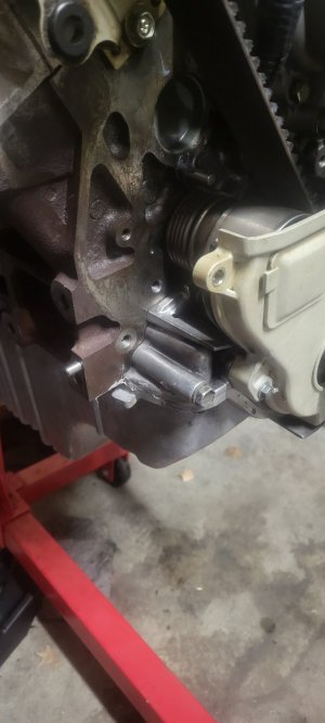

First, should I worry?
Doing a 3.0 to 3.2 convert, and i used the 3.2 oil pump instead of the 3.0, now I have a big ol gap in the belt covers
I'm guessing its fine, but would like a second opinion
I really hope i don't have to tear it all apart and put the 3.0 oil pump on

I made a small plate out of sheet metal to cover the gap.

Yeah, I considered suggesting that, but wasn't sure what (good) options there were for securing such a plate. How did you attach it @AREA 91? Thanks.

I drilled 2 small holes into the timing cover and used smallbolts and nuts with Loctite.
