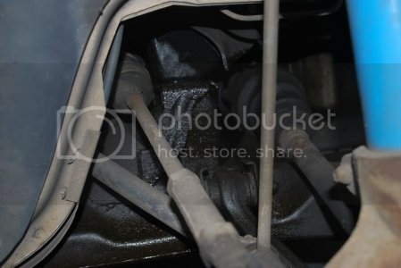

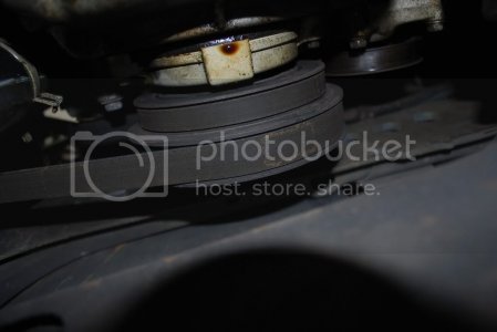

Ok...so its not the oil pan gasket or the oil level sensor... Here's what I found..
From the wheel well...
89leak001
Looking at the PS Pump Pulley...
89leak002
Underneath looking at the Crank Pulley.
89leak005
89leak009
And by the rear mount...
89leak010
So... A lot of it looks like its by the rear mount...however you can see the there is a bit by the crank pulley. For what its worth, The car does not smoke and the only time you smell oil is when the car is stopped after a drive.
What do you guys think?
(Yes, I know there is no Y-Pipe)
-Sam

Front main?
I'm under this silver 92, and, while there isn't oil all over it like yours, there is quite a bit. I think we have the same leak.

^^^is correct.
When it is all over the P/S pump like that it is most likely the rear cam seal, and maybe the valve cover gaskets contributing.
Obviously in order to do that you have to tear into it anyway. Might as well do the front main too.
