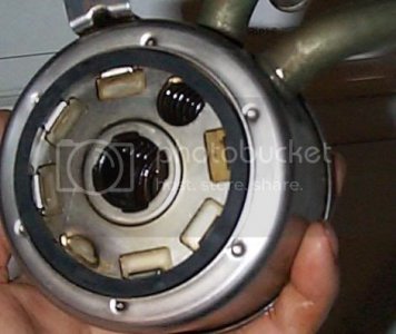

If you want a new seal for the oil heat exchanger to block, just take the seal off a new or old filter. It is a perfect fit and works. We recently did this on Scott's Remote-turbo SHO as the machine shop didn't give him his seal back. We just took the o-ring off a new filter and it poped right into the back side of the heat exchanger.
To remove the heat exchanger, use a larger socket (don't know the size, I always used a cressent wrench) and loosen the threaded post/****** that the filter screws on to. You'll see that the base of it has a place to put a deep well socket.

And to force this thread to take another breath...here is the setup I use...remove old filter...salvage the gasket, replace block gasket with old oil filter gasket.
Filter gasket on cooler VVV
Oilcoolerwithnewseal
