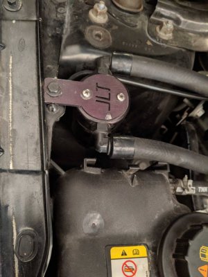

Does any have any ideas on how to mount a oil catch can on a 2013. I bought the universal one cuz i tryna be cheap lol

I did the same thing going the cheap universal way, get 3 feet of 5/8 hose and just route it a little longer, on the back. I'll post pics when I get home of mine. I had purchased some silicone fitting with a 90 for the back and a 45 for the ****** off the intake, both fitting blew up (literally exploded into pieces) as soon as I hit full boost. I also ran a 3/8 hose from the bottom of my catch can down the apron/rail to come out the bottom of the core support so I can drain the can without unscrewing anything.

The last one is hard to see but its the drain hose. The bracket I'm currently using is a place holder, waiting to get my welder back from my dad so I can fab up a nicer one.
