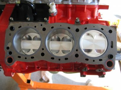

Main bearings aren't a problem. Rod bearings can be due to neglect and KNOCK. The bottom end on stock pistons will be good for about 400whp with charge cooling and a good tune. With forged pistons, the limit is fairly high... As in... We don't really know. I don't doubt that a well built motor can make 800-1000hp. For longevity sake, 400-500whp should do well.

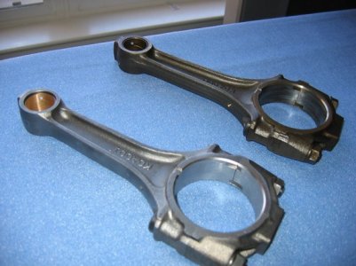

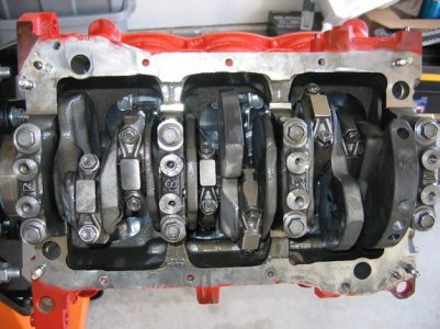

Stock crank and rods are forged. When I built my motor, I had the rods flash ground, resized, shot peened and new bushings fitted. I also had the crank micropolished and balanced. The motor on 14 PSI has done a best of 438whp. I built my 3.2L using my original 3L block and 5 rods (spun a bearing, found another rod). I sourced low mileage 3L crank and a NOS 3L oil pump. I also have a spare built motor in the garage using a 3.2L block/rods/crank.

My build:
3L rods. Stock vs reworked.
