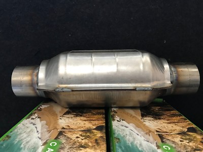

Can't tell if they physically fit or not. They need to be 12" or less inlet to outlet or the back one won't fit in the high flow Y-pipe. No dimensions given in the eBay listing so I pinged the seller.
BUT there is a second piece - CARB has to approve the cat for the application, and in the link to the approvals in the listing no Taurus, SHO or SLO, is listed. That approval (CARB or EO number) only comes into play (in Colorado at least) when you apply for a waiver if you still fail after installing new California spec 3-way cats. I asked Mike @ ShoSource about what CARB or EO number to look for and he said the only one approved for Gen 1/Gen 2 SHO actually does not fit. What do you expect from the people at CARB who just outlawed ICE engines...

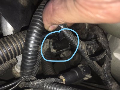

Presuming This is the SPOUT #1 connector, pulling it does not make the car pass NOx emissions. The reason I have doubts is what I presume is SPOUT #1 plug (picture 2) does not look like the picture in the archives. The SPOUT #2 plug under the coil pac looks just like the picture in the archives.
NOx would have failed the old limits with this disconnected. I also installed new O2 (Bosch) and ECT (Eichlin) sensors this weekend and fixed a vacuum leak in the evaporative emission system.... And bled a quart of water through a vacuum port into the intake to decarbon the cylinders.
HC and CO came down, but they passed the first time and did not need to come down. So my takeaway is pulling the SPOUT#1 may fix HC and CO, but clearly makes NOx worse.

SPOUT 1Spout cap

So this is a connector with a plug on it (no wires come out of the plug connector) so if it is not SPOUT #1 I'll dig a little further for another plug once the engine cools off.

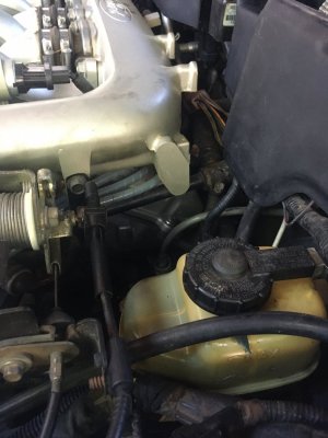

LR intake

did you see the link I posted in your want to buy add, it shows what the spout connector looks like

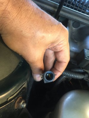

The Spout 2 I found looks just like the one in your link. I thought this was the SPOUT 1, as I did not see or feel anything else.
I have just come in from the car and it was cool enough to go spelunking a bit deeper and I did find a grey SPOUT jumper and promptly dropped it taking it out. 20 minutes later with the help of a borescope I found it and retrieved it :cussing:. Guess I'll go for a drive and see what it feels like. I also cleaned and put on a larger MAF I had sitting around on (stalled project from another life).
