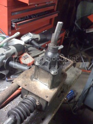

I love being able to weld and fabricate.... $$90 in parts, a couple days of brainstorming, and a day of work...
A shot mid way though fabrication.
IMG 0063
I have sampled how Jose's Mack-Daddy SHOrt Shifter feels/works, and This feels DAMN close. Looks 100% stock, feels 200% performance!
I also re-engineered the U-Joint with bronze oilite door hinge bushings, and poly bushings and also replaced the plastic bushing at the entrance to the shift housing with a bronze oilite bushing/washer making it all slop-free.
All for $90...
Thanks Matt!!! :thumb: :woo-hoo:

I do...I just like pretty, custom fab stuff sitting in my garage...
However, if you'd like to fab me up a shifter boss brace, we need to talk........

Boss brace isnt high on my priority list. All my mounts are bolted solid, the engine/trans doesn't move. I also dont try to dislodge the shifter from the floor on every shift.

but I will say that some bushings in your assembly would help you out greatly time.....dumb ford design.....
I have a shifter sitting around from another car I would like to see if I can modify it to fit a SHO.....only problem is I don't have a 5 speed SHO. :oops:

Would you mind elaborating on the build up? If you don't mind. I've had the itch to throw something together for the car, but just haven't had a set plan to go by per se.
I'm an excellent fabricator, so let me have it! :salute:
