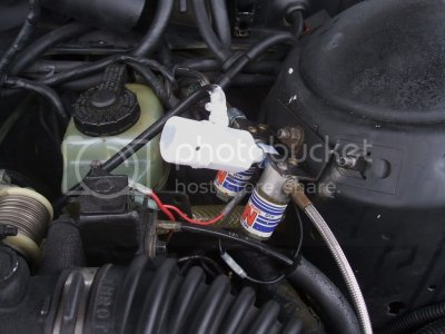

I pulled the solenoids apart as well as the regulator... everything seemed fine. Threw it all back together, and with the nozzle line disconnected as well as the FPR line I activated the system to see what it was doing. Everything looked normal, and I had plenty of nitrous coming out of the second solenoid.
Here is a picture of what is happening....
DSCF0763
This was right after a 1-4 gear run (upto 120). The system seems to be working now, I can surely feel and hear when the nitrous comes in. However, it seems like there is a miss while on the bottle. It only happens once, and it's a very fast miss. I can hear it through the exhaust as well.
I pulled the front plugs, and they look fine.

My guess is that it's still lean. (you know, because like, don't have a fuel solenoid and stuff)

Oh yeah, there's a leak inside that Josh. I have no doubts. Mine did that once and I had to replace it. From what I was told there are rubber seals inside that can be replaced but I never fiddled with doing that. And why they would use rubber seals in it I have no clue. Since I never messed with it I can't say whether or not the guy who told me that is right or not.

Yeah, after I posted my last reply I went out an swapped the plungers. The o-rings (aka seals) in both were fine, however, the nylon plunger was somewhat damaged on one of the plungers. Swapped them out and ran the car, and the regulator did not freeze up. It seems to be pulling fairly well now.

CosmoSHO
Jan 16, 2004
59
Fort Worth, TX
Looks like a leak to me
Definite leakage. Shouldn't be getting the snowball effect.
