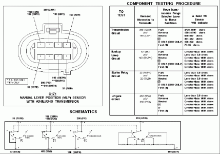

Could also be the TRS on top of the tranny. That feeds power to the relay.

The switch on top of the tranny telling the car what gear it is in. They have been know to cause issues. Try moving the shift lever a but when it won't crank May just need adjusting.

The TRS switch has been checked and is working correctly. I hit the starter several times with a hammer the last time it didnt start. No luck. I replaced the starter relay in the fuse box. No help,it still wouldn't start when its hot. It DOES help to open the hood for 20-30 minutes,or just wait until the sun goes down,then it starts. I have noticed the fuse box under the hood is cracked. I'm thinking there could be a terminal or wire(?) problem in the box.Any other thoughts?

Trs volatage values ax4n
