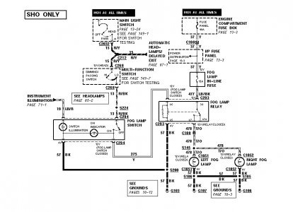

Says under the dash near the fuse panel attached to the main wire harness. Looks like directly under the headlight switch or near the ebrake pedal from the diagram.
The Ford wire diagrams show a 15A in line fuse for the fog lamps.
I don't have any experience with this problem, but I do have a service manual for a gen2.
I can't tell where it is by looking at the service manual, it looks like it may be part of the switch, or else near it.
Here's the diagram. Hope it helps.
2889493500 eea7512f4d o
That is what I found with a search. I am off to go see if I can find it then once I do, will have camera ready.

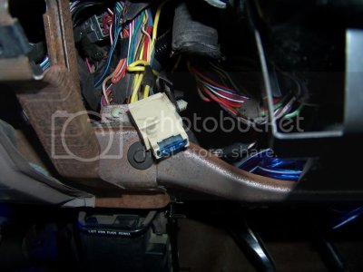

Found it!
With the bottom cover off, it's just above and to the left of the fuse block. I think it is supposed to attach to the frame of the dash. Mine was hidden away but I took a picture of it back in where I think it was supposed to be. My fog lights work now. Fuse was indeed blown.
