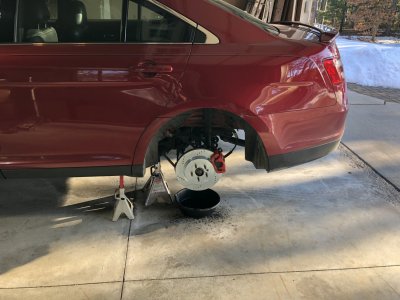

2013 SHO I replaced all the calipers pads and rotors. I bled the brakes and it has a great pedal. When I start up the car the pedal goes to the floor. I replaced the master cylinder with a new OEM ford. Bench bled the master cylinder and same issue. I bled the brakes and did not see any air in the system. The reasons I replaced all calipers was because I had a noise coming from the passenger front area it felt like a caliper sticking. When I started to replace the front passenger side I found that pads we’re worn evenly so that was a surprise not sure what cause the pulling and brakes to grab. Also I pulled the fuses to the ABS and ran the car on jack stands and still same issue. Great pedal until you fire her up. With it running I can pump up the brakes and they get firmer but once you let up on the brake and push it down again it goes to the floor. Any ideas what may be causing this. Thank you

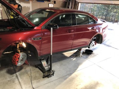

I am very sure it did not run out I made the swap for each caliper in less then 2 min the rears are kinda of different not the typical banjo bolt. I have read about using software to activate the ABS while bleeding the brakes. I have a feeling it could be something to do with the ABS. I wish I would have investigate the strange noice and pulling / brake dragging before I assumed it was a bad caliper. I have an appointment next Thursday at my local shop. I will let everyone know what they come up with. Thank you all for your help. At least it looks nice with the new brake set up even though I can’t really drive it you have to zoom in a little to see it.
