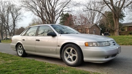

16X7 with 225/55/16

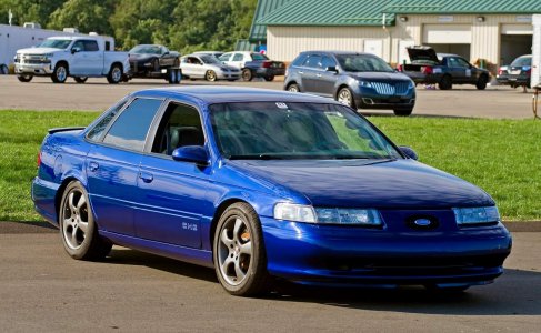

17x7.5 with 225/50/17

16X7 with 225/55/16
