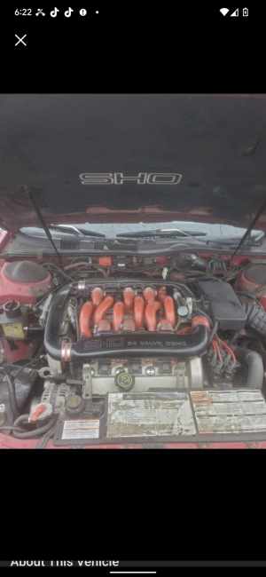

So long story short I wrecked my truck and needed a vehicle and I found this 92 SHO for pretty cheap. Thing runs and drives awesome. Very minimal rust. I'm happy with it. Straight pipe dual exhaust sounds ungodly loud.
My main question is what size wheels are people running on these? I kinda want to leave the paint looking old and faded get a nice set of wheels and tires and have a fun little sleeper.
Here's some pics of the new hooptie PXL 20220410 194838596

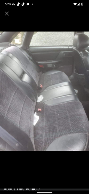

Good find. The interior pics you posted look really good and that is my number one way of judging how a car was treated. If they maintained the interior they probably maintained the car too.

Chad thanks for that answer that was the exact info I was hoping for. I think I'm going with 18x8 and wasn't sure if they were going to fit.
And yes besides one crack on the dash by the steering wheel and the heat/ac buttons faded and worn the interior is showroom quality.
