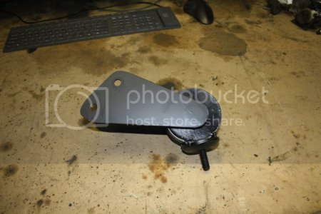

So, I decided to make my own. This first one is a proof of concept for my daily driver, that has a really bad front mount. I'll be making a rear mount for it as well. I'm confident in the design and the strength of the mount, but the only way to know for sure is to test it. If there's something I don't like, I can change the design for the next pair of mounts.
This is what I came up with:
IMG 5432
Grade 10.9 bolt for the mount, a front tension strut washer to give the mount a flat surface against the subframe, and some scrap steel I had laying around the shop for the rest. Filled with some Shore 80 flexible urethane (very similar to Flexane, different brand).
Before someone mentions it, I don't care about the paint runs, I painted it to keep it from rusting, not so that it would look good. Runs aren't ideal, but this is just a proof of concept. Next mount will be better.

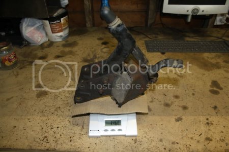

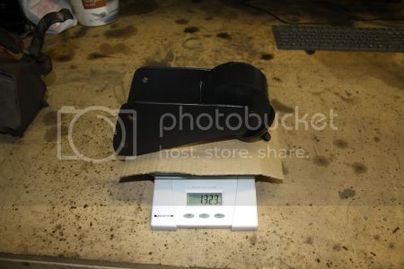

The other nice thing about this mount is the weight. It weighs nearly 1/3rd of the stock mount! 1.32kg vs 3.46kg, or in other words, 4.7 pounds lighter. Doesn't seem like a lot, but 5 pounds off the car in front of the axle centerline does help. Not to mention the difference the rear mount will make, and then removing the torque struts will have a big weight savings too. Every pound counts.

Great job.

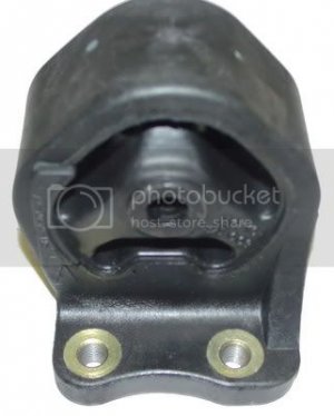

This is similar to an idea Ive had for years.
Only difference is that I proposed to utilize mounts that are already in production.
Similar to these, made for an EVO

I had thought of that too, but really, modifying something else to work is probably more work than making these. This is the same reason I made my own instead of reinforcing stock. I definitely wasn't looking forward to baking the rubber and scraping it out to repour stock mounts with urethane.
Now that I have the jig, and not including the curing time for the urethane, I could make a mount in an hour or so. A 3lb box of urethane is enough to make 6 mounts, too.

Excellent design. One thing, and you probably have already thought of it, but make sure you beef up the non threaded side of the mount with collars. I used big nuts that I drilled out to fit the shaft of the new 10mm bolts that I supplied with my mounts. I then "jigged" the plate to the cast iron AC mount to get the holes lined up, and welded the drilled nuts to the plate. This distributes the force of the bolt's rocking to a much larger area of the plate. Works very well. If you already thought of this, never mind.

I had thought of that too, but really, modifying something else to work is probably more work than making these. .
You are not following my idea.
The off the shelf mounts would not be modified.
All you would need are custom brackets to make the off the shelf mounts work.
So you would have a custom bracket on the motor side, that attaches to the mount with nothing more than a bolt.
And the off the shelf mount would bolt to a custom bracket, that would bolt to the subframe.
Easy peasy. :wave:
The idea is to limit the amount of cost involved to fabricate custom mounts.
using off the shelf stuff makes this easy. And eliminates any need for pourable urethane, molds, jigs, etc.

And, when the mounts eventually wear out or break, you can go into the store and say "I need a front motor mount for a ______ (insert appropriate car)", instead of having to repour urethane, etc. etc.
Although Advance Auto will wonder why they all of a sudden are selling 300% of the normal amount of Evo front motor mounts! :eek:

Hadn't thought of that actually. The stock mount isn't reinforced around the bolt holes so I didn't reinforce them when I made mine. In retrospect, it would be a good idea, I'll probably weld on some thick hardened washers before installing. Thanks!

No part number, I poured the urethane myself. No center bolt either, I didn't see the need, as there's a single bolt to take the mount off the subframe about 2 inches lower. This let me use a larger center pipe, to distribute the forces into the urethane better, and less complication than bushings and bolts. I used about $7 worth of urethane to make the mount, and mixed up way too much. Next time I'll only need about $4-$5 worth.
No, actually, I followed. My point was that it's more work to build those custom adapters than it is to make my mount. Granted, once you've made the adapters once, you're set, but you still need to buy new mounts. Repouring urethane is much cheaper, just more hassle. It would definitely be a bulkier/heavier solution as well (not trying to say you're wrong, just giving you my reasons for doing it this way).
Besides, I'm not planning on ever having to replace this mount. How often do reinforced SHO mounts go bad?
