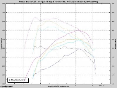

I'm pretty excited! I ordered the intercooler and cat'd down pipes yesterday!
With a 3 bar and a Gearhead tune, what kind of hp and tq numbers should I expect? ...Im trying to curtail my excitement somewhat. I've heard that the intercooler is worth about 40 and the down pipes are worth about 20. Is that about right?

Top line of that on 93 octane.13d8399b933314cddd67d9479160e710
Sent from my Moto Z (2) using Tapatalk
Is that wheel!?! My last Dyno was on a mustang dyno. With only a 3 bar and AJPTurbos tune, I pulled 321 awhp.
What did it make stock?
