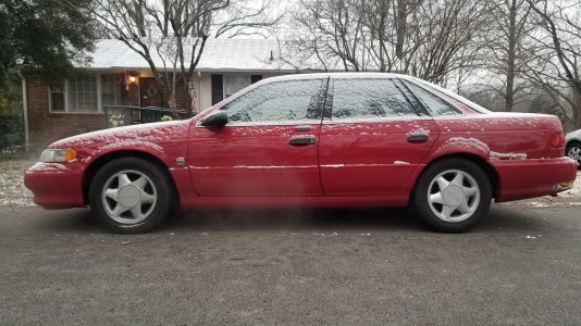

SO I just bought a 1991 SHO MTX with 136000 miles on it. It looks like the rear is sagging and Ive heard that the rear springs can sag over time. Can we find replacement ones?

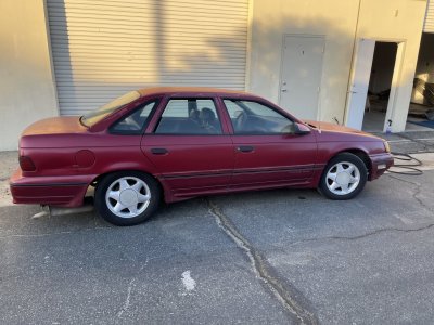

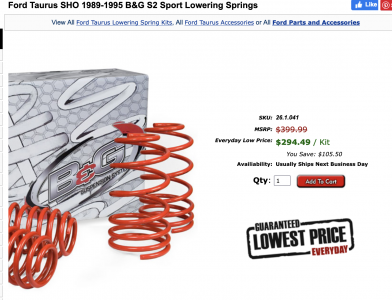

Ive heard of these too

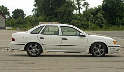

What does the preferred combo look like compared to the stock ride height? Also how different is that compared to stock as far as ride and handling are concerned?

can you still get B & G springs

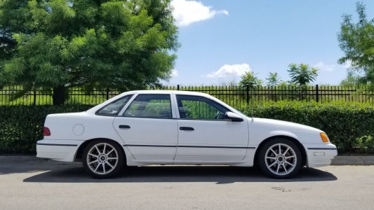

Ride is a little stiffer than stock which is a good thing in my opinion.
One front coil cut. Uncut rear.
20210112 071434
Two coils cut in the front. Uncut in the rear.
IMGP1563aA
Two coils cut in the front. One coil cut in the rear.
20221221 195348
