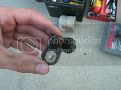

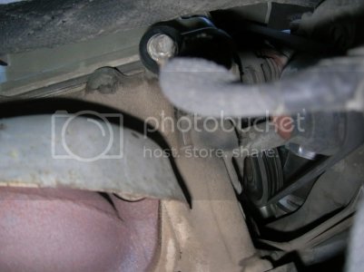

Maybe... change both sensors.
Cam sensor is like a five minute job tops.
DSCN0922
Front bank, right side, below cam cover. I think it's either 8mm or 10mm bolt. < $15 part from any parts store.
