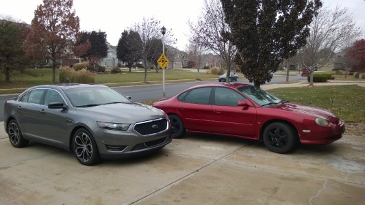

Just picked up a '13 SHO with all the features except PP.
What things should I be on the look out for the next 20-30k miles?
Still have my gen3 as well.

Welcome! I see you got the best color available what do you mean when you say things to look out for? Problems, issues etc? Or what mods to partake in?

If I park next to you then you need to be looking out for me "Accidentally" taking the wrong vehicle........Sorry couldn't resist.!!!! The wheels aren't me but color definitely is...That is my next color.
