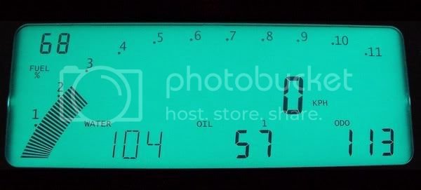

Those earlier Continentals all had digital dashes. AFAIK the only other one that might work would be one from a Windstar. They had a different digital cluster available but the tach stops at 6k....
