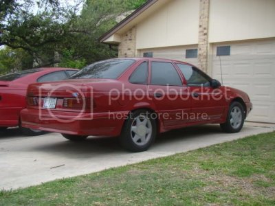

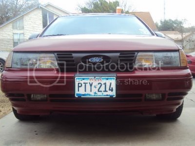

I have acquired a 91 MTX. It is throwing me 3 codes:
14: PIP circuit failure
19: CID Sensor failure
67: Clutch Switch circuit failure
I just got home from driving this car 450 miles (Texas to Kansas) Ran great except it stuttered at idle for a few seconds at a time. Never shut off on me at all. Could new CID sensor fix this? I could also start the car without the clutch pressed in. The guy just had the clutch replaced. Is it possible something did not get plugged in? If thats the case where should I look?
