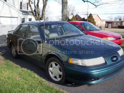

Here's the car...
01 1

Can't speak to the tranny issue, as my car is a '92 MTX. But the starting/dying issue sounds like what I had back in '96. Crank sensor solved it. The water pumps in these cars have that leaky weep hole, which pretty much drips right on the sensor. No problems since, although I'm probably on borrowed time. If it is the crank sensor, may as well do the water pump while you're in there. Good luck, car looks good, except for that flat right front tire.

His passenger front tire is goin flat also.
Doug
Yea, it was low. Thats at the guys house before we took it home. It was just low on air.
