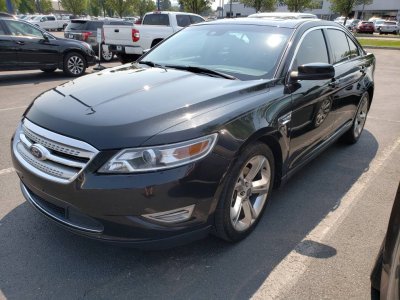

Well guys, I greatly appreciate the replies. Sorry I haven't replied till now. Literally slept about 8-9 hours total the last 2 days and have driven about 400 miles as well.
Long story there I'll have to touch a little on later. Laying in bed post my thanks before I pass out.
She ended up coming home with me even with all of their sales tactics. They didn't think I was going to make it happen.
This beautiful beast came home with me and she'll be loved the rest of her life.
Before anyone asks, I don't know of mods yet other than I'll be blacking out the ext trim ( recommendations always welcome ) and I'll be either repairing the rash and powder coating ( probably will anyway because I know a guy ) or getting aftermarket wheels. I don't know about black, I've always been partial to gunmetal grey. We'll see, something dark with a non gloss finish.
Oh. I'll also be doing some minor, very minor paint correction and then putting a ceramic coating onEba895a21b449ae4239c4112e533236d
Sent from my SM-G965U using Tapatalk
7,399
9,695
Looks good, the ceramic coating will make it pop.

Looks great! The only real performance mod should be a tune and you're pretty much set after that.
