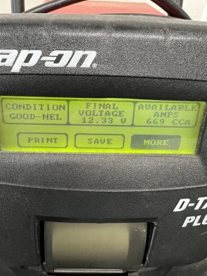

Battery is 2 years old and tested to have 669 cca out of 750cca. I don’t think the battery is junk but I’ll try to return it. I’m sure it’s still under warranty through ford.

even the best battery will start to sag if not fully charged regularly enough. just a question of how long before it becomes noticeable. i too have short drive cycles. even if the alternator is perfect, i would advise regularly topping up the battery on a standalone charger to prolong life. that or plan on replacing regularly. walmart platinum agm has 4 yr warranty as does odyssey. i would of course go with odyssey just because a) TPPL technology and b) significantly higher rated CCAs, but at nearly twice the price, you may be happier with
EverStart Platinum BOXED AGM Battery, Group Size 65 12 Volt, 750 CCA
still worth checking for a parasitic draw, of course, as the car/computers age.
