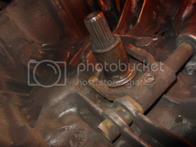

I just got back from looking over the car. There is a quill sleeve installed. With the replacement bearing on the sleeve there is still some rocking motion in the bearing. I also noticed that the fork shaft has some play in it so would think a new set of bushings would help there. When this clutch stopped working there was no bearing noise. It just would not release.

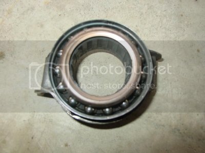

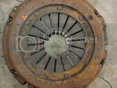

That PP & TObearing look just like the ones we pulled from the 89 we just bought.
--see, the TObearing has no seal &/or grease left in it!
--Yea, ours also had no weird noises to suggest the condition of the parts we pulled.
Yeah it's dry.. And all the other bearings I have has a black seal.. Maybe i'm just over looking the norm. And thought that the missing pin caused the fingers to wear on one side... and it was just the bearing locking up.
Typical MTX TObearing failure!

What usually happens (the last few clutches I've done were all the same)...
The fingers eventually get worn through. This happens naturally but normally takes a very long time...longer than most clutches last. But, when the TOB starts to get gritty and begins slipping on the clutch fingers, wear is accelerated dramatically. "End game" for TOB/pressure plate fingers usually goes like this:
One or two of them break and now when you press the clutch, those broken finger tips tear the seal on the TOB to shreds since they're too short to reach the bearing surface. You might not even notice this event and the clutch may continue working great for a while. One-by-one though, adjacent finger tips get worn through and more damage to the TOB occurs with each shift until eventually, a bunch of the fingers are broken and the clutch stops disengaging.
