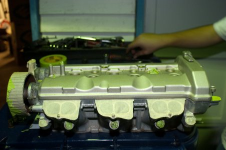

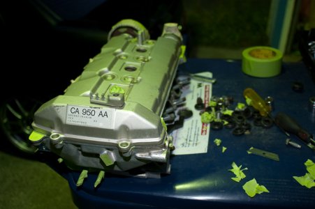

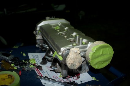

I stupidly didn't have my brother take pictures of the intake painting process, but there are a lot of surfaces that have to be masked when painting or powder coating, or else you run the risk of not grounding properly.
CRW 6144
CRW 6142
CRW 6141
 MG 7251
You can see in the last pic where the intake supports connect are unpainted on both the intake side and the head. That is also how I did plenum brackets.
