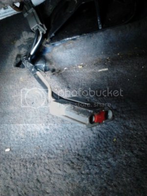

Name that connector! I suspect it's the reason I keep having air bag codes. I do not have any idea where it goes, the wires are black and white.

Pressure switch on the ATX driver's seat. It's part of the auto door locking system in ATX cars.

Yep. Connect it to the seat pressure sensor (if it is still there and functional) and your doors will lock when you put it in drive.

and it will not cause airbag codes, whether connected or not.
