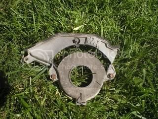

After trying to **** working on this PITA on my son, no such luck, I bit the bullit and took the front of the engine off to check the cam timing.
Two teeth off.
There was lots of debris inside the cover. From the lower timing cover. A peanut shell too.:oogle:
Timimgcover001Check this out.
For those that don't know, that curved window slicing through the middle isn't supposed to be there.:oogle:
How did this happen, and is it common? It looks about the right size for the outer damper ring, but the one I took off is in good shape, except one of the 8 mm bolt holes looked like the about half the threads had been pulled out.
And before I search and can't find iit, how do you test the CPS?
