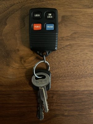

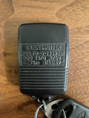

There was a Ford Accessories security system that had an ignition circuit interrupt ... the 92 I bought a few months ago had it as a dealer installed option. Can you post a photo of your fob? I'm a Ford dealer parts guy and if it it from Ford I can maybe I.D. it.
cheers
Ed
NorthStar243
Aug 2, 2021
7
9
Charlotte, NC
cheers
Ed
IMG 0385IMG 0386
fast Ed
Ford lover
Nov 15, 2008
174
60
Caledon, Ontario, CANADA!
That's just the factory RKE fob as you were thinking, hmm. No further insight from me on this unfortunately! Mine has a different fob.
