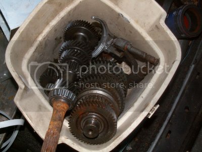

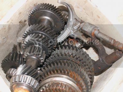

Selling these tomorrow and totally forgot about the damage to a few of the gears. Figured id put the pics up so the buyer can make his decisions based on public discussion.
the only 2 damaged gears that ive noticed are the 2 i show below, both of which i beleive are part of the shaft they are on, making the shafts worthless other then being a neat way to hold the other parts till they get used.

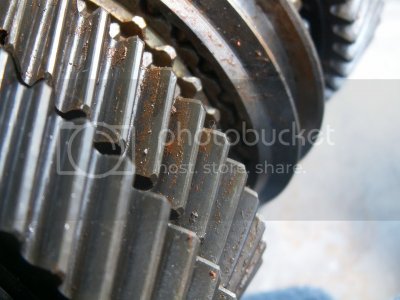

looks like the diff pin / broken case chunks hit this gear:
PICT0043
which is the mate to the one in the bottom of the bucket to the far left here:
PICT0040
and another view of the bucket as a whole.
PICT0042

any gearset w/ chipped teeth is worthless - at best it will whine, and it will be much easier to explode. about all that would be of value from that trans would be the shift forks and shift mechanism.

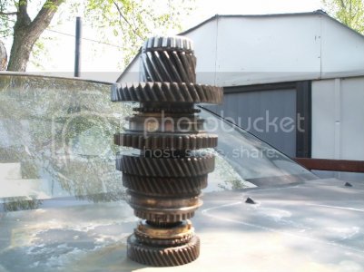

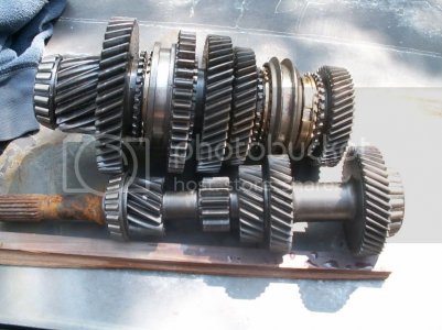

heres the input and main shafts together, input shaft needs to be cleaned up some obviously, The mainshaft ITSELF is worthless BUT everything ON it is undamaged
PICT0051 1
Mainshaft alone. The largest gear and everything below it is removable,
PICT0047 1

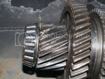

the other damaged shaft (again, not suggesting anyone should use this...)
PICT0049
and so that noone thinks in selling a rusted gearset ... proof that it whipes clean with a rag
PICT0050
