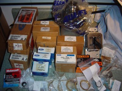

I think I had one of the last full sets of rotating parts when I rebuilt mine some time ago:
Trannyparts5b15d
As for the MTX75?. Sure, anything is possible. You would have to fab up a bellhousing adaptor, swap in the hydraulic clutch parts, and make some custom axles.
