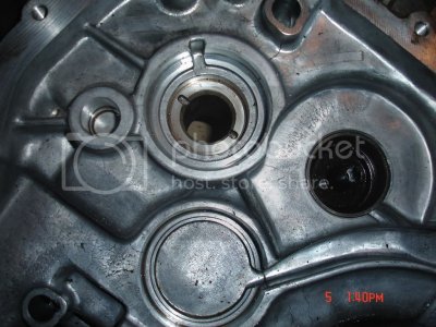

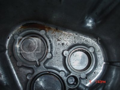

I recently took apart a MTX and notice that the internal surface of the case is "cracking." My question is...is this normal? Or should I toss the MTX case? It doesn't seem to be cracking all the way through but if you run your finger across the surface you can feel the rough cracks. Any answers will be greatly appreciated. Thanks (i'll try and get pictures soon)

The finish on the MTX case, especially inside, does look like it's cracked. It is normal for it to look that way.
However, that doesn't mean that you may not have a crack. A pic would be good to make sure, or just get a very close look at areas of concern. Usually it's just the normal surface finish.

Just rough casting marks, I wouldn't worry about it all. Notice how there isn't any on any surface that was machined?

Yup, it came out that way from factory , nothing to worry about. I've opened up some GM trannies that looks exacly the same.
