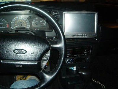

40BelowSummer
Dec 28, 2003
1,819
54
Puerto Rico
91' SHO: Head-Unit where EATC was
EATC in top DIN slot
In-Dash screen in bottom DIN slot
93' SHO: In-Dash screen where EATC was
Head-Unit in bottom DIN slot
Let me know if I can help

40BelowSummer
Dec 28, 2003
1,819
54
Puerto Rico
Thought I would snap some pics since Im nice. My interior is Dert-tay!!
*Notice WTB Mocha seats in my sig :rofl:

Looks like a real nice set up. is it kind of hard to see sometimes in your 93 with it right there? thats where i wanted to put mine also but wasnt sure if it would get in the way or not? Is your DVD player rightin your headunit?
