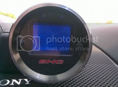

I have all on your list except for the cat back exhaust. You will love it, this is how the car should of come. I know you will enjoy it. I have a '12 with PP. I just made a trip to Mexico, and tried the performance part of my Aeroforce gauge. Funny, its faster on the street than the track. This is my fastest time too.
Aerforce20time zpsl721etqz

Where'd you get those gauges? That looks clean.

They are Aeroforce gauges, and there gauge pod. I really love them and the only real ****** is running the wire from the OBDII data port to the gauge pod. There is a lot of metal reinforcement behind the dash.
