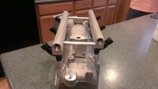

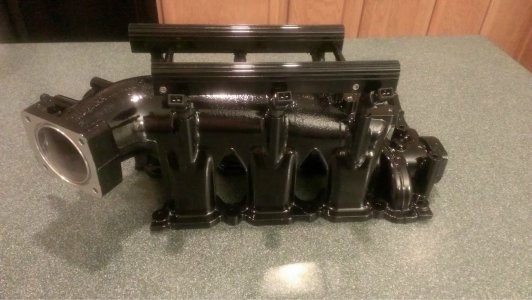

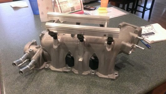

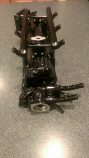

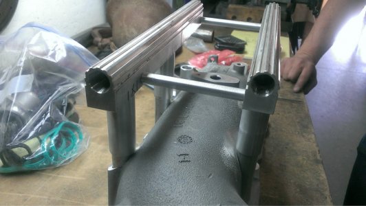

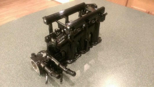

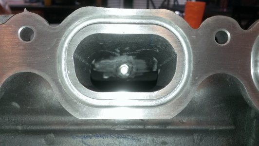

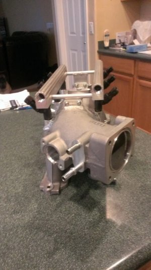

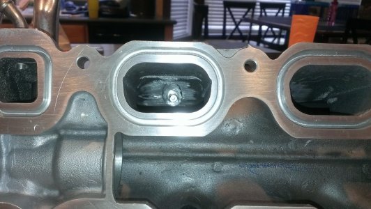

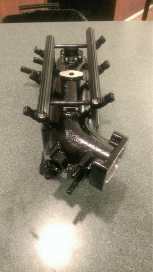

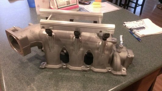

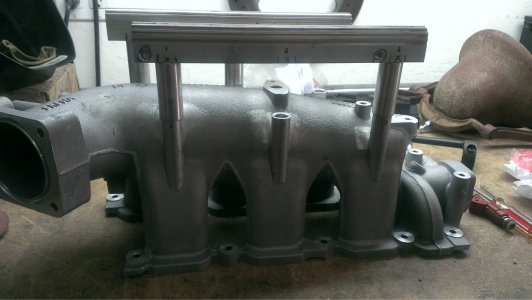

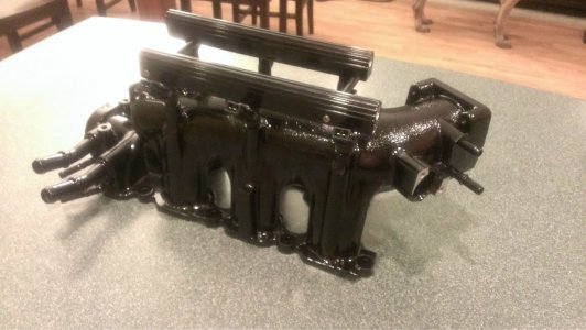

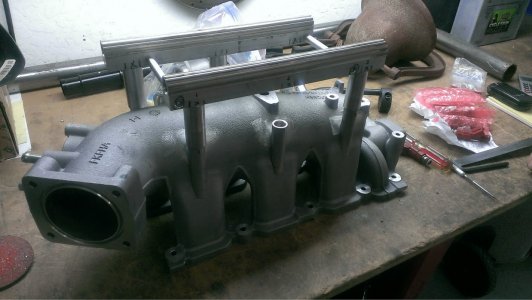

Adding 6 injectors to allow for additional fuel for the new turbos and running full E-85 soon.
This will be the next step required for 500+ WHP on the ecoboost platform. Will help support my new turbos coming next month and running full E-85 in the car.
11 second Flex anyone? :)

Very interesting! :naughty:
Any hood clearance issues with the new rails hovering that high over the OE intake? Or you planning on dropping those vertical pieces down a bit?
Kudos to you good sir for pioneering this effort! Bravo :urock:

I should have 3/4" with the tall injectors but if I install the short LS style injectors it will drop those fuel rails 3/4". I will probably do that pretty soon.

I think we need to give it a name worthy of its' looks & promised power :)
