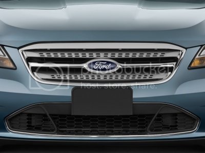

Ok, back to the ACC issue with this grille. I don't really know how the ACC sensor works however I wanted to find a picture of my cars lower grille to discuss a few things.
I found a picture of a non-ACC equipped Taurus limited shown here:
Taurus 4 door sedan limited fwd grille 100315877 l

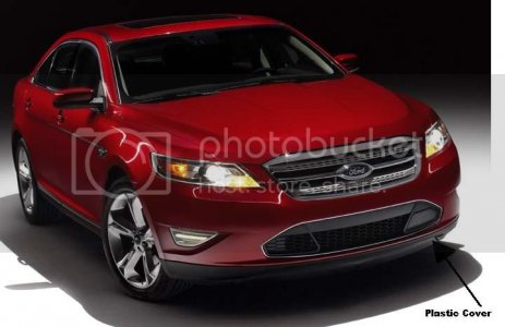

On my car with ACC, the left hand side has a black plastic cover over the trapezoidal opening but since this car doesn't have ACC, both trapezoidal openings on either side are clear.
Here is a smaller picture of what my lower grille looks like:
TaurusSHO
Does this mean that the ACC sensor is behind the right hand side of the grille that doesn't have a plastic cover over it? If this is the case, I don't think that we need to worry about the mobsteel grille. If however, the ACC sensor is behind the "blocked" opening, something may need to be used to cover this.....
Can someone with some knowledge of the ACC system chime in?

As far as the ACC sensor, yes, for those cars equipped with the ACC, the driver's side (in order to anatomically correct) of the lower grille opening does have a solid cover.
I inquired about this when I ordered my SHO (w/ non-ACC after I learned what it was) I was told that the sensor is directly behind this solid cover.
It's solid in order to protect it from the elements of mother nature.
Since I never thought of this, as my SHO is sans ACC, it was never an issue for me.
But I'd suspect for you guys/gals that do have it, probably are going to need to figure out either relocating the ACC sensor, or possibly come up with some other plan to block and/or cover it so the sensor doesn't crap out on y'all.
Thanks for chiming in Mike. Any printouts that you have regarding the bumper removal would be GREATLY appreciated.
What you said about the location of the ACC sensor is what I feared. I think the solution that I will use will be to cutout the plastic cover from my factory grille and perhaps attach it to the mobsteel grille?
Or perhaps I should contact mobsteel about this before I go any further and see if they can come up with a solution?
I wonder how sensitive the sensor is without being covered? hmmmm
