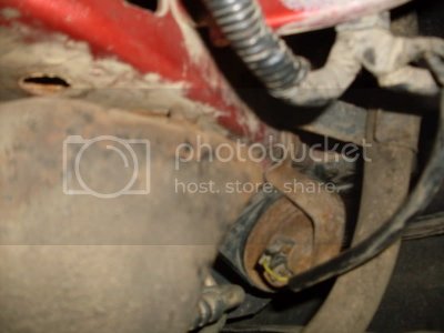

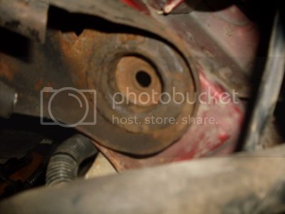

So....I've been dealing with an unholy sounding "clunk" emitting from the right front for a while now. I had noticed that the right front subframe bushing, when the subframe was supported by a jack, was disturbingly loose. Problem was, I couldn't find a way to effectively get a wrench in there to tighten things up.
Well, today, I decided enough with being nice, got brutal and managed to be able to wrap a wrench around the nut to get the bushing out. Thing is, there appears to be part of a bushing missing.

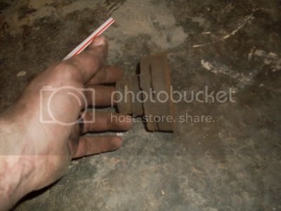

This is what I removed, minus a nut and bolt. this is ALL that came off, just to be clear.
SDC10979
This is the view from underneath.
SDC10976

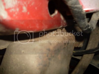

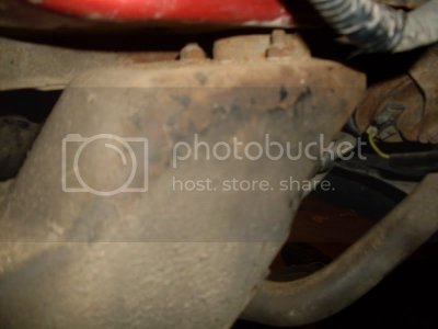

couple of side views of where the subframe meets the chassis.
SDC10977
SDC10981
SDC10984
The subframe is currently sitting on a pair of jackstands, but i'll be damned if something shouldn't go between the subframe and the chassis....call me crazy, but that just don't seem right. Suggestions? Ideas? Random musings on foreign politics?

That all looks normal. The front SFB are different than the rears. Alot of people replace the fronts with rears. The four small (about 1/4-20) bolts and metal cup were at one time attached to the top rubber of your SFB. It does not look to be in bad shape, so you should be able to use it for now. (till you get a new one) As long as you can tighten the bolt properly.
Mr Anonymous
Tire Wall
Apr 24, 2002
7,317
1,947
St. Louis, MO
Above reply pretty much covers it, except that now that the studs have separated from the bushing it allows the subframe to bounce around. I would not reuse them.
This is what the bushings look like new:
This is what the rear bushings look like:
Night and day.
