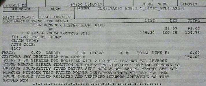

The memory module recently went bad on mine. The symptom for me was that I would randomly find the passenger mirror pointing to the sky.
Yes, the memory settings adjust the seat, pedals, and mirrors.
I should note that my local Ford dealer hadn't seen this issue and had to call Ford for assistance, ha. They thought only the Lincoln's had this feature....
@markathome, thanks for this info, would it be possible to go over your records and find out the PN of what was replaced back then?
jman1200
Dec 5, 2017
695
644
Ontario
Awesome, thanks. This confirms the PN listed on Tascaparts.com is the same they replaced on yours.
