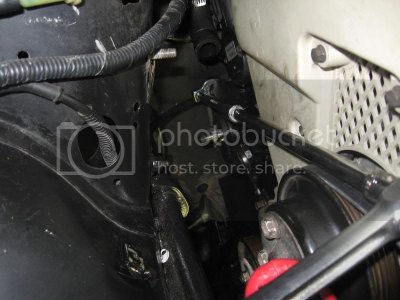

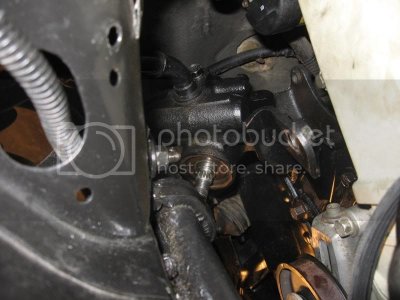

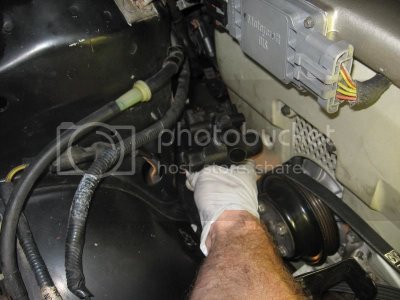

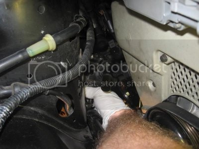

You need to loosen the HP line fitting before you unbolt the pump! I use a crows foot wrench as described in my write-up and pictures below. This is all the dis-assembly that is required to get the pump out. No need to go through fender well or remove motor mount or jack the engine, at least on Gen II MTX.
IMG 0259
Removing HP line with crow's foot wrench
IMG 0260
IMG 0262
Loosening the tough to reach rear mounting bolt, flex socket at the other end of the extension is not visible.
IMG 0275
Removing the pump from the top
