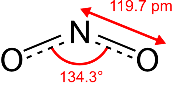

That is a multi-tiered answer.
1. The 2.3L is not simply a ported over and slightly modified NA motor from a non-power adder car. The 3.7L Cyclone engine was never meant to be made into a twin turbo motor. On the other hand...the relative architecture of the MazdaSpeed 3 engine was designed to be able to handle boost. That is just the power of the foreign tuner market.
2. If you can do the math you have the answer:
Upm4Y
