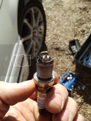

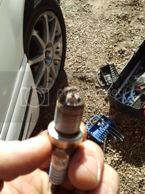

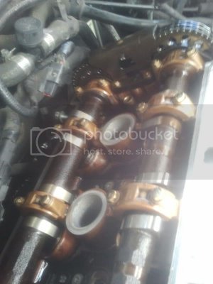

I searched and everyone had larger particles I have thousands of tiny ones.????? Rod bearing maybe? No knocking?? Thanks.
The spark plugs have around 3,000Miles on them The Middle ones on the Front and Back both had oil on them.
2012 01 20115507

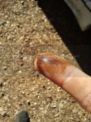

HEre is the best picture i could get of the Metal in the oil
2012 01 20115813
The Plastic looked really good

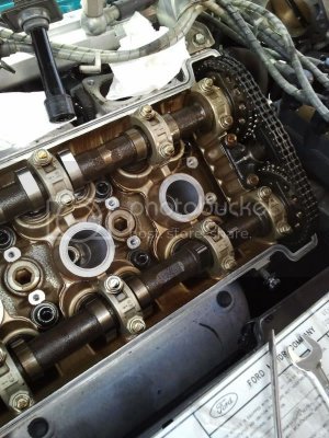

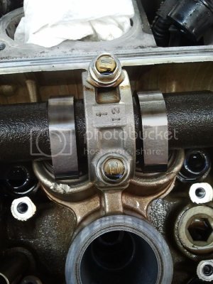

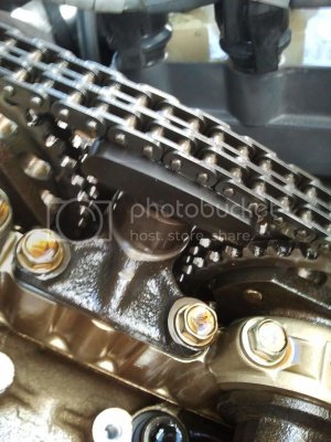

2012 01 20120044
Here are some randoms, Everything looked really nice up top. Now for the bottom.
2012 01 20120102
2012 01 20124048
2012 01 20115520
ANd this SHITBALLS
The Front 2012 01 20120110 1

first off, go get a magnet and see if its iron based. my guess is no it isn't.
try pouring some sparkly oil on a paper towel, then use some solvent to wash away the oil. have a good magnifying glass?

In addition to the other recommendations, pull the valve covers. Check timing chain tensioners, cam lobes. Blackstone labs can analyze an oil sample with the metal particles in it.

As Bob pointed out in post #16, bad cam chain tensioners (which are mounted onto the head) can cause the chains to hit the inside of the valve cover, and grind away at the aluminum. Ejected or displaced valve shims can cause cam lobe wear... Lots of stuff to see under there.
The V6 SHO engine uses steel timing gears and a timing belt, all on the exterior of the engine. On the inside, under the valve covers, are steel chains and sprockets that drive the cams.

Sweet thanks guys. My Sho is coverd in about 2 feet of snow right now so i'll just drive the blazer. The car only has 87,*** miles on her. But ill pull the valve covers first soo i can see whats up in there. (give me the chance to fix a broken VC bolt also.) If i see nothing, ill then pull the Pan. (and even if the rod bearings aren't bad ill replace them. Right now is a time where i wish i had a garage to work in.
