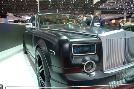

I googled and found these..
Matte world 08
Looks like you can see some clear coat on the hood there.. because mine dosent shine like that...
Matte world 04
Am I missing something? I'm kind of a paint noob myself.
