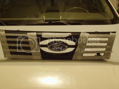

Well a few weeks ago i went to a junkyard with a friend and i found a '89 SHO. I decided to get the grill and it only cost $9. I have wanted a police grill since i got my car. Since I got this one I decided I'll try making it into one. I measured everything out to be the same on both sides. I taped up the parts to help while cutting. I'm going to use a cutting wheel with my dremel. Any suggestions before, while, or after cutting?

blacklabel said:
I was just going to use the cutting wheel. Would it be better to drill the corners first?
I think it would be...otherwise, you will probably end up with "notches" in the corners.

I would do a little different, I'd cut the inner, matching the oval, would be different and get more air.

I started to cut the slots out. 1 down, 7 more to go. Then the sanding. And while cutting you definently need to wear at least some glasses or goggles. Bits of plastic were flying everywhere.

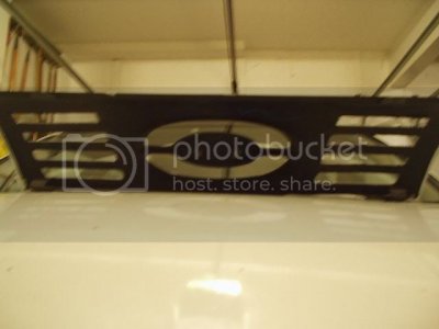

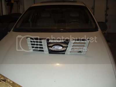

Heres the pictures. All i have done so far is cut out is one side. I still need to cut the other out and then sand it out and what not.

Lookin good! maybe I need to send you a gen II bumper cover with instructions to cut....

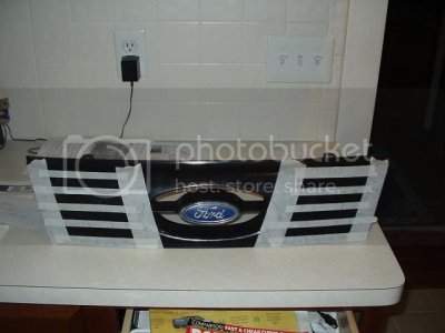

Well I finished cutting out the slots. All that is left now is to smooth the edges then possibly put it on and see how it looks. Heres some pictures with all the slots out.
Grill4
And the back.
Grill3
I'm most likely going to do the smoothing tomorrow. I'll probably have a picture with it on tomorrow. I can't wait. :corn:

are you purposely giving us blurry pics so we cant see where you messed up?? J/k it looks good but now you are going to have 20 guys wanting you to cut theirs out at the next convention!!!

Yeah the pictures are kind of blurry because it was cold in the garage and i couldn't keep the camera steady. Cutting it out isn't too difficult. I'm going to try and finish it up today. Maybe I'll bring the dremel along to the convention :cool: , thats if I go, which i want to.
