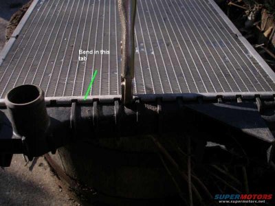

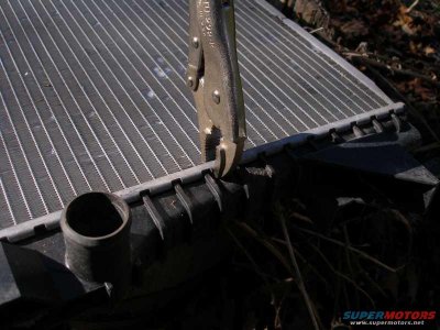

Probably leaking from the drivers side of the radiator. I had a brand new one that did this. Same problem the V6 SHOs have. You need to take the radiator out and recrimp the tanks.
Radiator crimp w hi lite
Radiator crimp 1
Set the vice grips so they do not completely squeeze in the aluminum tab. Start with it barely doing anything and tighten the grip slowly until it just pinches the tab a little bt. You will get a feel. Go all around the radiator. You can get all the tabs but two or so IIRC.
