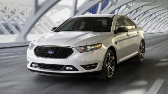

I have a problem with the ends of the lower grille. Looks like delete panels... that is, it looks like something is supposed to go there, but was not included when choosing options. I was thinking of putting a Hella FF 75 Light Kit there which are driving lights. I think they would be great on back roads and on the Thruway at night. Being very low to the ground, I would think you wouldn't have to turn them off for oncoming traffic, unlike using high beams. I also like the way they look... at least in the rendition below. I'm guessing it would be quite a project mounting and aiming the lights, getting the look and functionality right.
19215118916 e87db6d229 o
Edit: updated image

Might work easier for the PP SHO than the non-PP with ACC package. Looks good tho.

Looks good there, but the SHO is AWD...maybe put some tow hooks in? Lol

The ACC package puts a "radar" for cruise control & other functions behind that driver side "blank".

Thanks SHOdded. I was just looking at the dash for where I could mount the switch. The dimmer switch spot would be perfect. I never use it anyways. I picked up (Henry forgive me) a Toyota fog lamp switch, with a blue indicator light... would match the dash color. Guess I'm getting a bit anxious, planning all this stuff. The new SHO ought to be here in 3 weeks.
