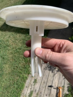

Finally got my fuel pump ring tool today and it made quick work of taking off the ring. I pulled out the fuel sender on the driver's side and found the issue. There is a yellow/orangish colored pipe that the fuel level sensor connects to. That pipe had broke off the bottom of the fuel sender cap that the ring holds in place at the top of the fuel tank. So the fuel level sender was just floating in the middle of the fuel tank. I am going to see if I can get a new pipe or if I have to get the whole unit. Guessing I will have to get the whole unit. I put it back together and it looks like it is working but that pipe was clearly broke and it is just a matter of hitting a big enough bump for it to fall off again.

I looked around at all the junkyards and none of them had the correct fuel-sending unit. From Ford, it was a little over $100 for it. I ended up finding an aftermarket unit for $50 on eBay. It ended up working perfectly and was installed in a matter of 15 minutes. I was worried I would need a fuel line disconnect tool and could undo the clip by pressing it together and pushing it through. The only tricky part was keeping the O-Ring on the sending unit and putting everything back together. I just got back from the gas station and it is finally able to read a full tank and the code has gone away.
Attached is a photo of the broken piece and a picture of the new aftermarket sending unit.
New Sending Unit:
IMG 5289
Broken Unit:
IMG 5291
IMG 5292
