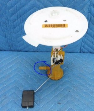

These tanks have two top openings on the top, one on each side. Looking for these pics I just found this diagram that shows a "fuel pump assembly - right" and a "fuel pump assembly - left".
Capture jpg
The one on the driver's side is just some kind of fuel level sensor, that's it. I just googled the PN and this came up:
Capture1 jpg
It does have a hose fitting at the bottom, not sure what goes there.

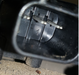

Went to remove the pump, disconnected all 3 plugs and thought "what if one of these is making a bad contact?"... sprayed them all with electronic cleaner and carefully bent (just a bit) each pin to ensure it would make good contact. Then noticed that the connector that goes on some sort of line sensor (???) was not locking (no click). Number 3.
Capture
Checked and noticed that the seal that goes way inside the connector was out of place, probably rubber has expanded after so many years. Using a thin nail played with it for a good ten minutes until I was able to put it back in place and get the connector to go all the way in and click (I now love that noise). Car started right away after that and has not failed since.

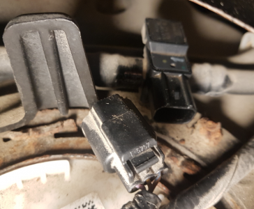

After looking through the engine and not finding anything obvious, I went back to the connectors shown on post #18. I disconnected plug #3 and plug it back and the car started. This time I thought "I have to get rid of this car..."
Made it home, removed that connector again, applied lots of electrical cleaner, slightly bent the pins to ensure good contact and plugged it back in.
A week later car died once again. This time all I had to do to get it to start was wiggle the cables feeding #3. So, at this point it looks those wires are either internally broken or the plug has a bad female pin.

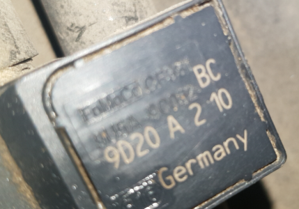

I took a pic of what I was told it is a fuel pressure sensor:
1636988604816
1636988636837
1636988966130
I searched that PN to no avail. I don't think the issue is the sensor(?) so I've been looking to replace the connector with a section of the wires feeding into it.
Last Saturday went to one of the local scrap yards and none of the 3 Taurus they have had it. This yard rips out the gas tanks and just cuts everything attached to them. Went to another yard but they were closing. The guy said they had 3 Taurus still in their fenced area that should have what I need.
I plan to replace connector #3 with as much wire from the donor vehicle as possible.
